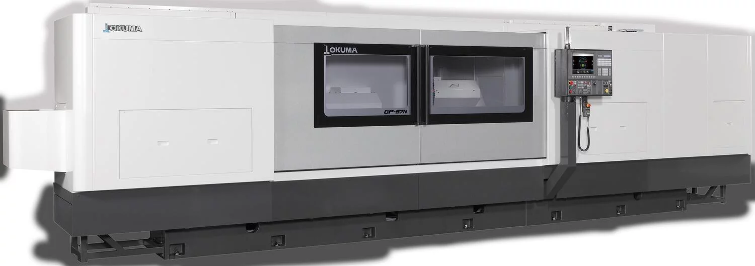

The Okuma cylindrical grinder GP-N series is designed for precision grinding of large parts.
Highly efficient and accurate OD grinding of large workpieces up to 3,150 mm length and 1,800kg. The hydrodynamic wheel spindle provides heavy-duty and high-precision grinding with shorter cycle times. The GP-N series is equipped with the OSP-P300GA control for grinders. Its outstanding user-friendliness increases work efficiency.
