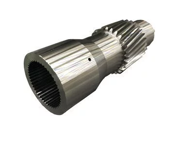

Input shaft
Automotive
Material: HNCM220M
Performing ID and OD gear cutting all on a one turret lathe
  • Hobbing and skiving processes, which normally requires spezialized machines, can be done on a turret lathe
  • Gears and splines can also be machined
  • By using a double tool holder, multiple tools can be attached to a single too, holder to maximize toll utilitation on a turret lathe
  • Using a double tool holder with the Y-axis function allows high efficient machining
Achive that machining with
