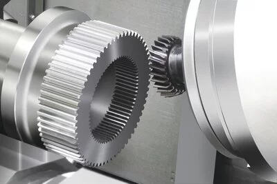

Advanced gear manufacturing and 3D gauging
Okuma’s Gear Manufacturing Package presented at the workshop allows for highly productive manufacturing of gears on multitasking machines or 5-axis machining centres. As the package includes turning, milling, skiving and hobbing in one machine, all necessary manufacturing steps can be completed within one setup.
