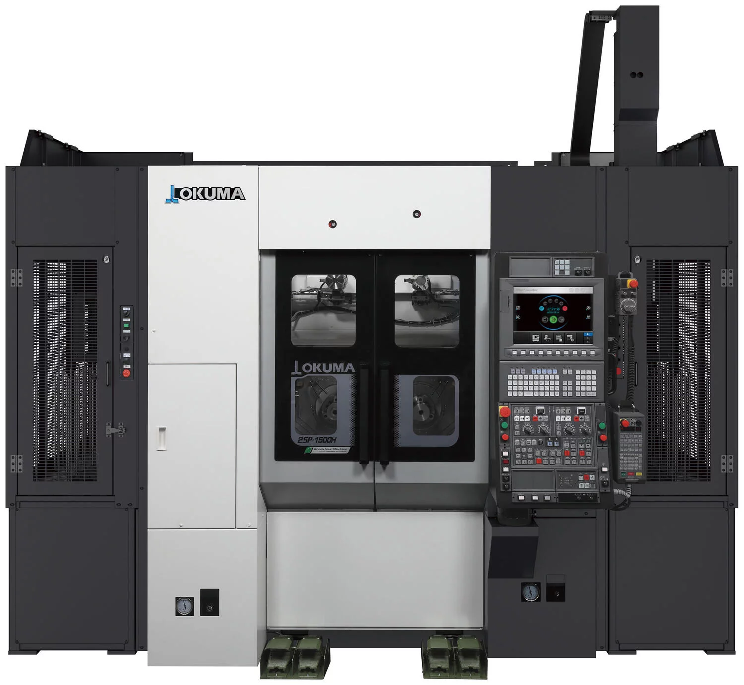

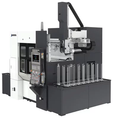

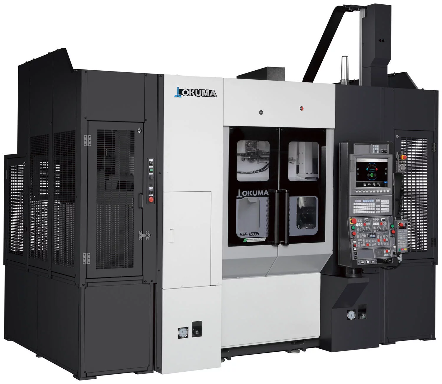

The innovative front facing spindle of the Okuma 2SP-H series helps create the most automation-friendly lathe for small-parts production. By moving the spindle off the side and incorporating the Okuma Gantry Loader (OGL) into the production line, parts can be loaded and unloaded automatically. An extremely compact footprint improves floor space utilisation. The popular dual spindle option significantly reduces cycle time.
