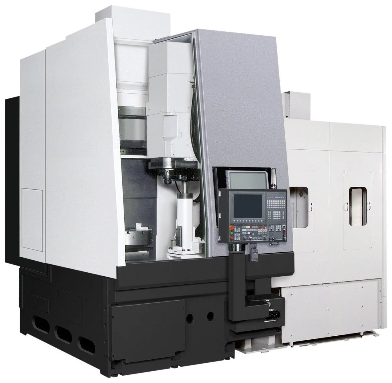

The Okuma VTM series 3-axis vertical turning center combines the benefits of a vertical lathe with those of a machining center. The 50 taper 36-tool magazine enables VTM series machines to offer both turning and milling operations on a single platform. They are the ideal machines for efficient low volume parts production, including valve bodies and work that requires heavy milling. Okuma box way construction and wide, angular slideways on each axis provide high rigidity for accurate machining. A vertical axis counterbalance assures smooth, stable feed at all speeds. The headstock is fixed to the base, minimising the influence of thermal changes and vibration on cutting accuracy. VTM series machines are available with a wide range of standard accessories, including a spindle orientation function.
